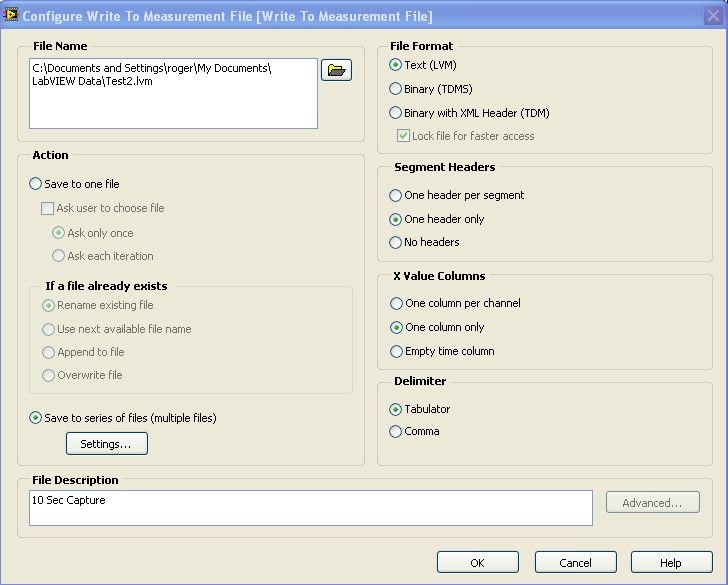

Hey Richard,
That is very strange, changind write to measurement file should not change the graph color or the scale. I have never seen that before. As far as getting time data into the file here is the config that I use.
This will have one time col. time data. let me know how it goes.
lab
