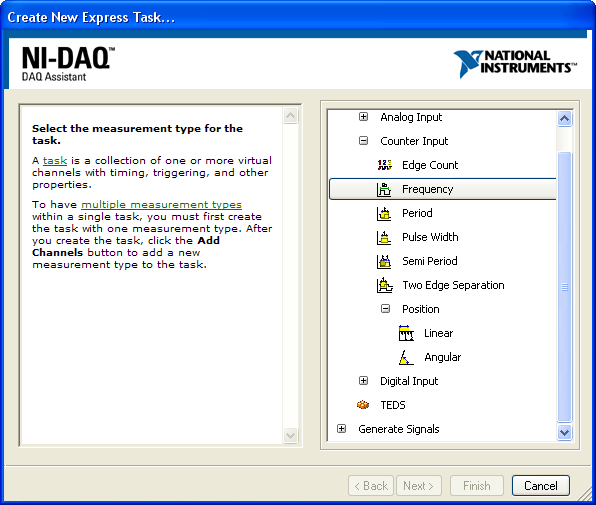

A very good screenshot, that proves that your signal is perfectly fine!
It seems to me that you are only interested in the frequency of the pulses, to determine RPM? You could do a DAQ Assistant Frequency measurement:
Connect Phase A of the encoder to the recommended PFI line in the DAQ Assistant. The issue with this method is that you won't be able to detect direction of rotation, please indicate if this is a problem!

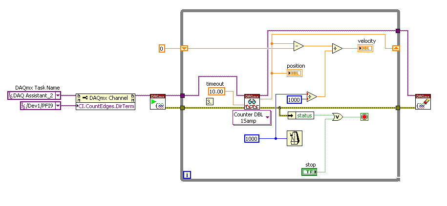

This example uses the Pulse Count DAQ Assistant with Count Direction set to External, converted to a task, then example code generated. Then I insert a property node to change the assignment of the Counter Direction Pin to one of the PFI lines (PFI9 in example). Phase A of the encoder is connected to what the DAQ Task suggests (PFI8 in my case) and Phase B is connected to the Counter Direction Pin that you set with the property node.
The example works for me, and gives me speed, and speed is positive in one direction, and negative in the other so you can detect direction.
There is a bug if the counter goes below 0, it underflows to the maximum counter value, which makes speed jump very high for 1 loop.

Your VI works for me fine! The numeric indicator for speed is off the screen though (data 2) and this is the one that shows speed. Could you post a screenshot of your DaqMX task?

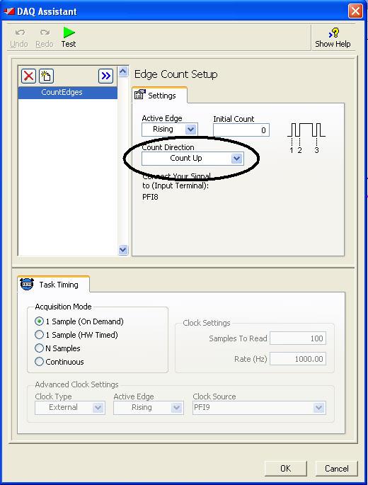

I could not see these settings on the VI you sent, as the DaqMX task only exists in your MAX panel.
Could you change this setting:
To Externally Controlled
