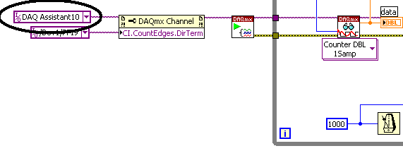

It means that the task you have specified here does not exist:
To check if it exists, right click on the Task constant (the bit circled above) and click Edit NI-DAQmx Task. If it doesn't exist it'll start the process of creating a new task.

Dear Mark,
I do not think that it is an error about existing. Maybe there are some problems when I set some parameters for DAQmx channel and those configurations are invalid. So, my VI does not work. But so far, I do not know what the error is.

I have found this knowledge base article which describes the error you are having and a potential fix. Could you try this please?

Dear Mark,
Thank you very for your helps. That document is very helpful to me.
