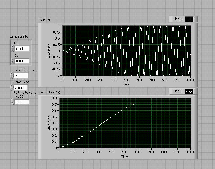

That said, if you happened to have discrete points of an AC waveform (say, +/- 1V across a shunt), it is possible to convert them to an RMS value fairly quickly: http://en.wikipedia.org/wiki/Root_mean_square .  You might also look into the various RMS VIs in labview (I like the one called RMS PtByPt).  After appropriate scaling you might end up with a reasonable picture of current through your shunt.
Since the 6008 is only 12bits / 10ksps, I worry that you might not get a very good reading depending on how fast your inrush is and the frequency of your source.
Quickie simulation using a *slowly* ramped up sine wave:
This all assumes that you're still alive after setting your system up 😉   Sometimes it's best not to leave these things to chance! NI does make high resolution, high voltage, isolated multimeters capable of current measurements that would give you a much better picture without all the hassle of math, shunts and possible electrocution 🙂
