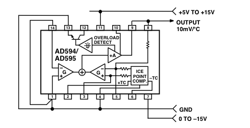

Have you put an oscilloscope on your USB-6009 inputs? Maybe you have oscillation. Have you bypassed the power supply pin 11 to ground with a capacitor? Though the example circuits in the data sheet don't show capacitors, I'd certainly add one.
I'd recommend something like the AD595 data sheet's basic connection circuit (Figure 1) (shown here), with the addition of a 0.1μF capacitor between pin 11 (the power supply input) and pin 7 and 4 (ground).
Your USB-6009 should be connected differentially:
  • the USB-6009 + input to pins 8 and 9 of the AD595
  • the USB-6009 - input to pins 7, 4, and 13 of the AD595
  • ground of the USB-6009 also to pins 7,4, and 13 of the AD595 (run a separate wire over to the AD595 circuit; don't just connect the USB-6009 ground to the USB-6009 - input)
  • the USB-6009 5V output to pin 11 of the AD595 (with a 0.1μF capacitor added near the AD595 between its pins 11 and 7)
If you duplicate the schematic given in the AD595 data sheet as Figure 13 (shown below) (connect pin 7 to ground) you will have a simple thermometer (this circuit replaces the thermocouple with a short circuit). Does this work? If you heat the chip, do you see the output increase?

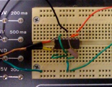

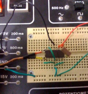

Hopefully you can see the wiring from these two picturesThis is using the basic connection along with the suggestion of adding a capacitor between the supply voltage and pin 7I still haven't resolved the issue though.  Using a multimeter or oscilloscope provides the proper mV reading, but I cannot figure out why the DAQ is susceptible to this lower cutoff.
