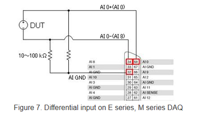

We have also followed the recommendation by top-left of TABLE 1 in this article: https://www.ni.com/en/shop/data-acquisition/measurement-fundamentals/field-wiring-and-noise-consider...
But the signal voltage is pulled down to a even unnormal values (R1=R2=60K ohms, the voltage is 0.6V/0.0V at 1G/-1G), TABLE 1 cannot solve our problems.
We feel it is about grounding.  We also tried to connect AI- to AI GND in 6216 but problems remains.

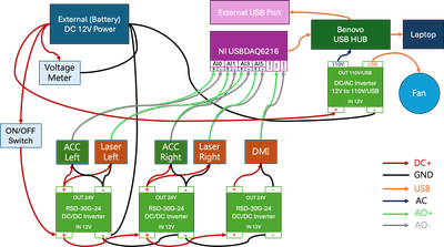

Please share a simplified electrical connection diagram of the connected components and possibly a photo of the setup.
Santhosh
Soliton Technologies
Message 5 of 12
(708 Views)
Hi
Below is our simplified electrical connection diagram. Thank you.
Message 6 of 12
(697 Views)
Your DC/DC converter may be an isolated version and you need to connect the output GND of the 24V to the GND of 12V supply. And as well use resistors to AIGND since you use it in differential mode.

THANK YOU.
We have put resistors between AI- and AI GND (but 24V GND and 12V GND is not connected) then the voltages measured is pulled-down.....
Do we also need to connect 24V GND and 12V GND?
And do wen need to connect 12V GND to NI's AI GND?

Since your Accelerometer can output in differential mode, you are not required to connect 24V GND and 12V GND as long as you have bias resistors from AI+ and AI- to AIGND.
Do you have any other single-ended signals from sensors powered by 24V?
Santhosh
Message 9 of 12
(664 Views)
Hi
We have put bias resistors between AI+ / AI GND and AI- / AI GND.  However, it doesn't work.
We put 100K Ohms and the voltage is pulled down and biased 0.4V (1V --> 0.6V)
And if the we put smaller 10K Ohms then the voltage becomes 0v....
BTW, we also have laser displacement sensors which is singled-ended but we also connect it in a differential way.
