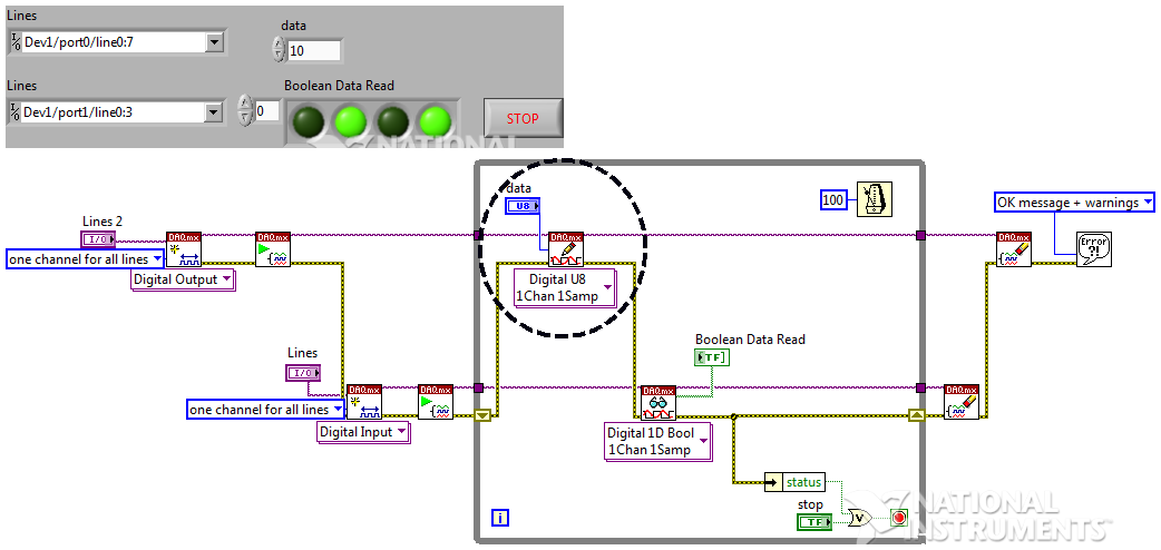

skip the leds all together, do a write/read to the daq itself and all you need is some wires...goto the ni find example>>daqmx>>digital generation>>write digital channel.vi (assign it port0)and then goto>>digital measurements>>read dig chan.vi, but assign it to a different port (port1). put both write and read in the same while loop...NOW YOU HAVE "VIRTUAL LEDS"! Smiley Very Happy
  • wire directly from p0.0 to p1.0..and so on, till p0.3 to p1.3.....
combo.pngHAVE SOME FUN NOW!!
