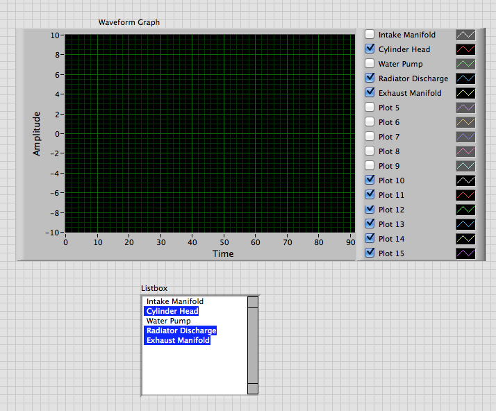

There are many ways you could set it up for the user to select the channels to be used/displayed/saved. A simple method is to have an array of boolean buttons. The user presses the buttons representing the channels of interest. A Multicolumn Listbox is another choice. It would allow you to place meaningful names on the channels like Intake Manifold or North Vent. On the graph you can show Plot Visibility Checkboxes, but expanding the Plot Legend for 16 plots takes a lot of front panel space.
Lynn
