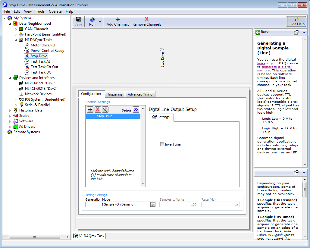

unfortunately, I can find the "Connection Diagram" button on the right hand tab. What is wrong?
You've said "Then to create the task select your PCI card, right-click and select “create task” follow the wizard to create you task. Once these is done click on “Data Neighbourhood” menu and select NI-DAQmx Tasks and click on your task and look at the bottom of the right hand tab and select “Connection Diagram”." But when I click on the task there is only a help discription on the right hand site which doesn't really help to find the connection diagram.

You are showing a digital out task - not an analog input like your subject. I don't believe there is support for digital connection diagrams. Click on your AI task. Also, what version of DAQmx are you using?

The tasks shouldn't be the matter as for analog out and analog in tasks the connection diagram do not appear, too. By the way, even a digital out task should have a connection diagram or where do you want to send the signal to?

The tasks do matter since not all of them have wiring options (i.e. RSE, Diff) and there is no such thing as DAQmx 4.6. Just expand the software listing in MAX.
The pin numbers when you right click on the device and select 'Device Pinouts' are the pin numbers on the terminal block board. For example, Port 0, Line 4 on a PCI-6250 is pin 19. Wire to pin 19 on the terminal block.
