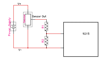

I’ve been thinking about including a 1000 ohms resistance if the power supply is 10V but I cannot find the reason of it. As NI9215 has +-10V input range (and there is also a voltage drop because of the sensor), why do I need to use a resistance? And if the voltage supply is higher than 10V, why do I have to include a voltage divider? I attach the scheme of the circuit I am considering (The resistances are provisional in function of the answer I get). Please let me know if I am wrong. Thank you so much again.

The sensor acts like a switch. It connects the output line (the one you have shown connected to R1) to the V+ line when the target is sensed. If you had no resistor, it would be short circuiting the power supply from V+ to V-. The likely result would be the destruction of the sensor.  By connecting R1 and R2 as shown below some current will flow from the sensor output to ground when the target is present. This will cause a voltge drop across R2 which is then measured by the NI 9215.  The values of R1 and R2 are chosen so that the maximum voltage across R2 is less than the 10 V limit fo the DAQ device. For a 10 V power supply R1 could be zero ohms (a wire in place if the resistor). If the power supply is 24 V and R1 is 1000 ohms, then R2 would be 1500 ohms.
Since the negative side of the input to the DAQ device is at the power supply negative point (ground), single ended input configuration is appropriate.
