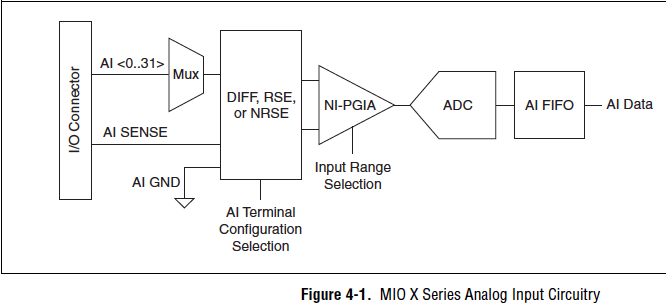

General purpose devices such as a multifunction DAQ card and a connector panel can be used in so many configurations that it is almost impossible to fully specify the input impedance in a way that would be both meaningful and accurate. Consider Figure 4-4 of the X series User Manual:
The Mux (multiplexer) is a switched capacitance circuit. The terminal configuration box has more switches. The PGIA (programmable gain instrumentation amplifier) probably has more switches to select gain ranges.
If you are scanning multiple channels, several of those switches change state every time a differtn channel is selected. There are capacitances to charge, charge injection from the switching process, and (probably) small changes in the exact resistance and capacitance as seen from the input.
The nuclear physics instrumentation with which you are more familiar probably has a fixed preamplifier with well defined 50 ohm input impedance and any range changes are done after the preamplifier where they have no measurable effect on the input impedance.  It also costs an order of magnitude more.

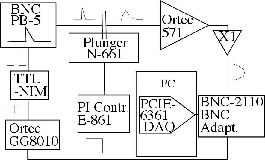

things are not as compilcated as they seem to be. I actually calibrate the distance-capcaitance, using the capacitance to do feed back to keep a distance of some 10s of micrometers constant within some tenths of micrometer. This means I can calibrate before each experiment, and each experiment is a week or so. So I need a setup stable in time over a week, and temperatur changes during experiment. Having tried my simple setup I have tried moving cables etc and its does not disturb to the point that I care, that is changes are smaller than the error I tolerate. I'm more worried about
1 Stability in time/temperature
2 Noise - we do experiments close to high voltage accelerators, large vacuum pumps, with vibrations etc.
To let you know more in detail what I'm trying to do. I'm trying to replace this scheme (the X1 amp is actually before the ortec 571) included with as few and cheaps parts as possible. This might not be possible but I feel it should be...
Each box is a few thousands of dollars and a nim create and something that can break etc... The BNCPB5 is a high precision normally used in nuclear spectroscopy, the ortec 571 is a shaping amplifer (exp signal to semi-gaussian) and then some boxed to create a gate for the NIe6361 daq. The E861 is a controller of a piezo motor to do the feed back

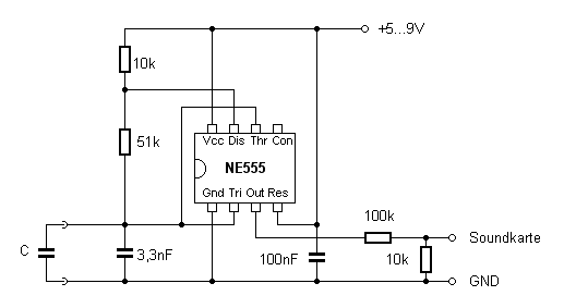

Well, here is a simple capmeter  that do a C to Frequency conversion:  if you replace the 3.3nF with a 1nF MICA(!)  and use metal resistors and stable supply voltage this is worth a try!
You can use perf board but if you have a small metal box and a BNC outlets just glue the DIP  dead bug to the housing and  and air wire the 6 components 😉
EDIT: Here ist a ready made layout: http://www.gaedtke.name/programmieren/kondensatoren-messen-mit-der-soundkarte
the page is in german, however the pics tell everthing 😉
you can use nearly anything to measure the output frequency, timer or AI of the DAQ, soundcard, or even the CTS-input of a RS232
source: http://www.elexs.de/radio4.htm
Get this circuit close to your foils,  provide a stable supply (maybe an extra 78L05 )
