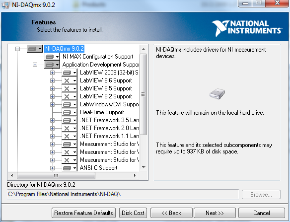

I'm attempting to upgrade to LABView 9.0, but only have DAQmx version 8.8.  I updated to DAQmx version 8.9.5, but still don't have the supported VIs available in the block diagram.

You are correct, DAQmx 8.9.5 is the first version of the driver to support LabVIEW 2009 per the following KB. I recommend installing the latest version of DAQmx, and make sure you have the support selected for LabVIEW 2009 like the attached image.
Hope the second time is the charm.
