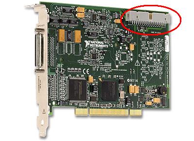

its me again, i was reading about the card and i dont know what this ports are for, i mean the one that is inside the red circle, i want to know if this port is the real time system integration (RTSI) or is a aditional power conector to allow the card to provide more powerni pci 6221 68 pines.jpg

Hi pedrorivera,
That connector is indeed the RTSI connector, the PCI-6221 does not use an additional power connector.
