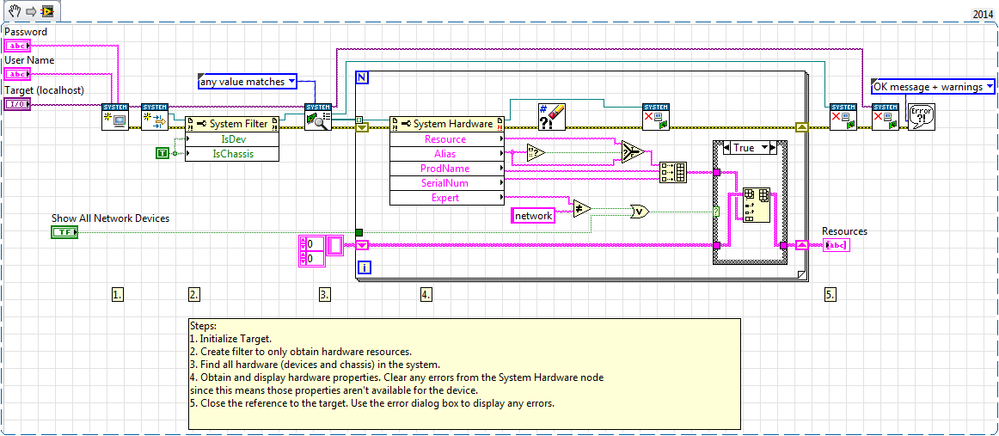

If you go to Help > Find Examples there is a good examples called "Show All Hardware" under Hardware Input and Output > System Configuration.
There are many more properties under the System Hardware node that may be specifically what you are looking for but this should be a good start.
