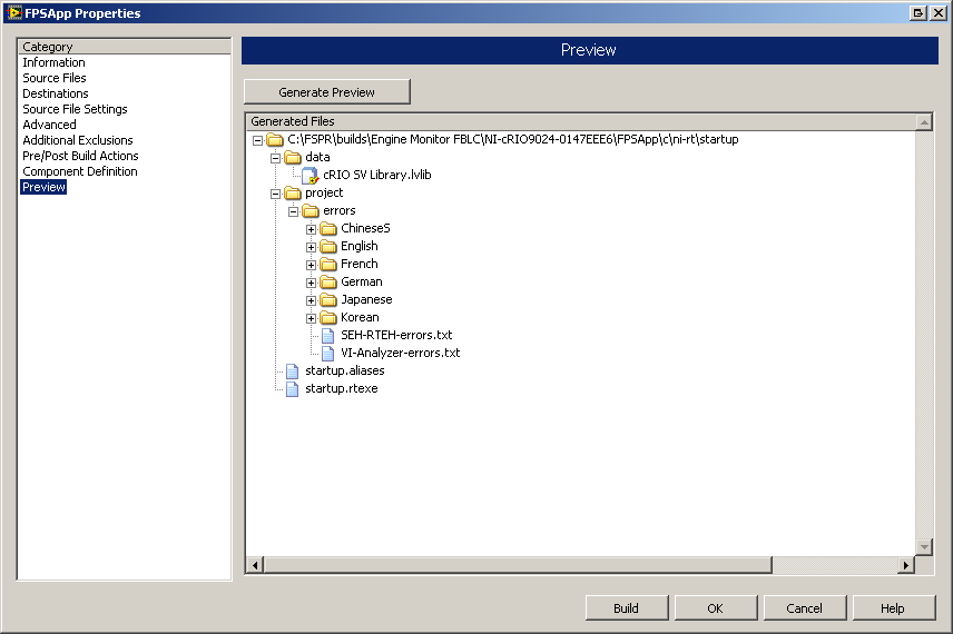

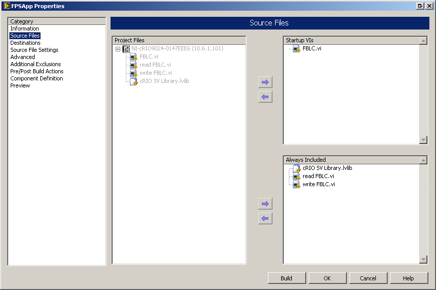

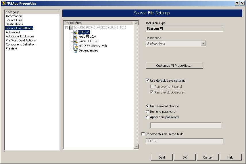

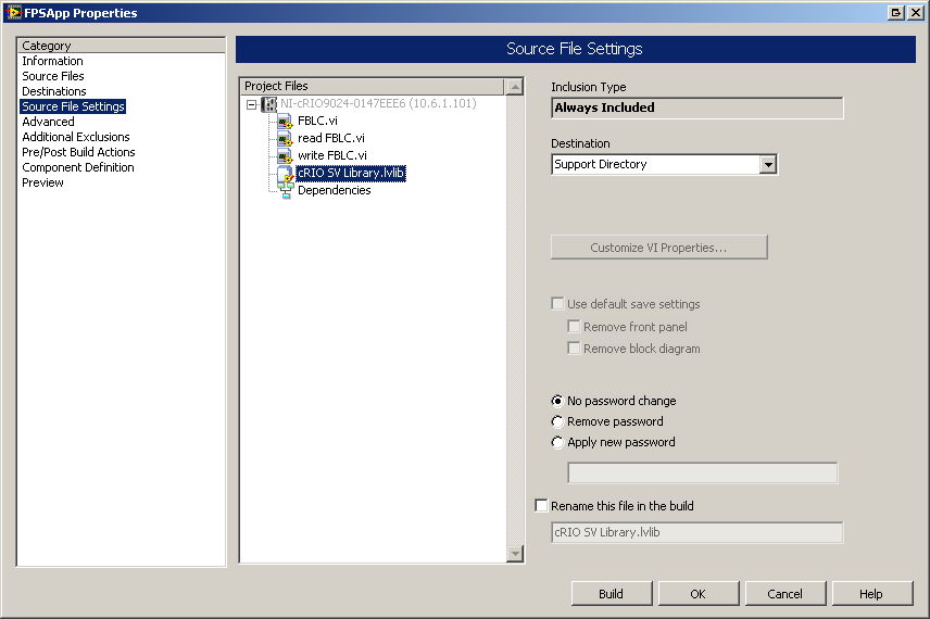

I'm trying to deploy a SV library as part of the startup.rtexe for my cRIO.  How can this be done?  Enclosed are screen shots of my build properties.Picture1.pngPicture2.pngPicture3.pngPicture4.png

I did not follow any of the suggestions in the white-paper.  I found making sure the "Disable Autodeploy Variables" was not check resolved the issue.
