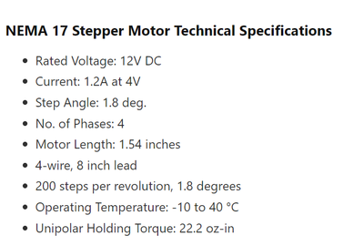

See attached the motor specification:
(2,504 Views)

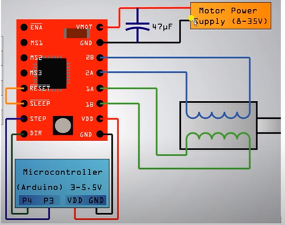

Hi   and ,
Thanks for both of your help on this issue, I greatly appreciate it.
After some more research, I have come across example circuitry, making use of a NEMA17-compatible driver, however, I was wondering if the USB6008 would be able to replace the microcontroller in this example, and therefore sending the signals for step and direction.
(2,434 Views)
With the USB-6008, step pulse timing would not be consistent and the top frequency would also be limited.  Both issues are due to the need to toggle a digital line with software timing because hardware timing isn't supported.
You could probably generate some motion as a proof of concept, but you won't get constant or particularly high speed.
-Kevin P

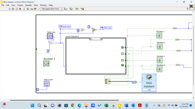

Good Evening Everyone,
I am trying to control stepper motor without using Arduino. I have written a Labview code generating 4 outputs in a cyclic fashion which will allow my motor to rotate. I am Stuck in between on how to wire my hardware correctly and send my generated signals to the driver in such a way that stepper motor can rotate.
I will attach my code in the section.
It will be a great help if anyone can guide me through it.
(2,050 Views)
