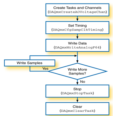

Hello aranteg
The problem you have is that you are implementing a "software timed" analog generation. This means that your generation is controlled by loop iterations. Instead of that, you need to implement a "hardware timed" generation, so using onboard clock (a sample clock in your DAQ hardware) you are going to control the generation.
It's right, you need to use the DAQmxCfgSampClkTiming function in order to convert your task from software timed to hardware timed. You are getting the error -200462 because you need to write to the buffer before you start the task when the generation is hardware timed. (you were not getting the error before because if the task does not have timing you can start it, then write to the buffer).
You can also try to use the examples installed together with DAQmx. You go to start menu>>all programs>>National Intruments>>DAQmx>>Text-Based Code Support
