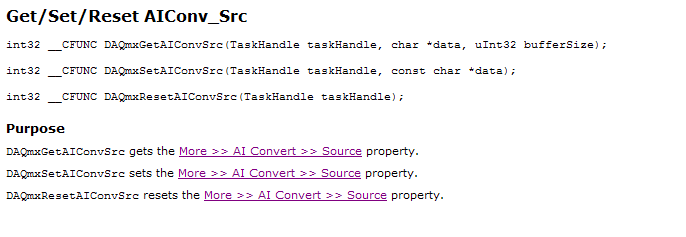

How would I configure the convert clock to come from the same source as the sample clock in ANSI C?  It's not immediately clear to me what functions I should use.
Message 3 of 9
(5,093 Views)
Hi Chris,
I guess I should have asked which ADE you were using--I hope my previous post still made some sense (most of the DAQmx functions are direct mappings between LabVIEW and C).
You actually don't have to do anything special to use the same line as the convert/sample clock other than tell the driver that you want to do so.  To set the convert clock source in C you can use DAQmxSetAIConvSrc:
John

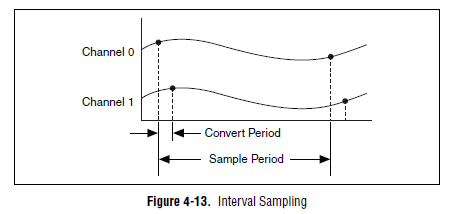

The sample clock is necessary to start the beginning of the scan list.  If we were sampling two channels of ai we might want to sample the two channels relatively close to one another but only take the next pair of samples after a slower signal has occurred.  The following diagram from the M Series User Manual helps illustrate why we still need to specify a sample rate even if we give an external convert clock:
In the above diagram, the convert clock could be a much faster signal than the sample clock, but extra ticks after the first two would be ignored until the next sample clock edge (assuming 2 channels in the scan list)
So, the sample clock starts the beginning of your scan.  Once the scan finishes, the device will wait for another sample clock edge before taking the next scan.
