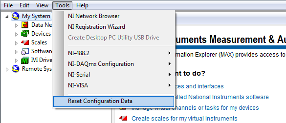

In the new versions of MAX (5.3.1), there is a more robust reset option. It can be found under the Tools menu, and it's called "Reset Configuration Data." You can see it here:
I hope this helps.
