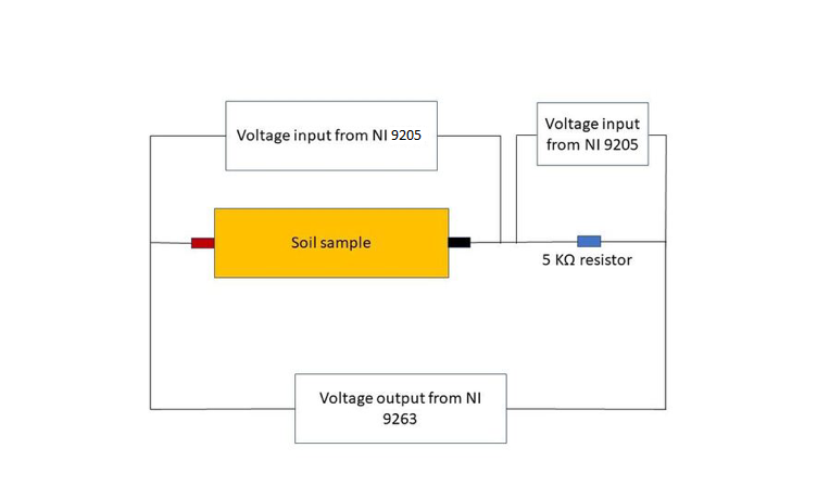

I have just received a cDAQ-9184 and three modules, NI9263, NI9201, and NI9205. I want to measure soil samples' resistance by using a plexiglass box with two electrodes on the two ends ( Miller soil box). After I have been playing with cDAQ-9184  for a week, I had two plans for this task.
1st plan, connecting my soil sample with a known resistor (5.6 K ohm) in series, and output a constant DC voltage (10 V) by using NI9263. And measure the voltage across the soil sample and the resistor by using NI9205, so I can calculate the soil resistance by R1/R2=V1/V2.
For this plan, I have finished the vi ( very simple, mainly using DAQ assistance) and tested it, which is working. I used a FLUKE 743B process calibrator ( multimeter) to check the divided voltage for soil sample and resistor, which gave me the same measurement with the LabVIEW. I also tried to measure the current by connecting the multimeter with soil and resistor in series, the current measurement is reasonable too. But the problem is the results by using this method is different with the expecting value from another device called NILSSON soil resistance meter 4000, which we usually used as a reference value.
And also, the soil sample's resistance is not constant for my study, it will be changed by changing the water content or freezing the soil sample ( it could be 1000 times different). Maybe using one resistor is not enough, I will have to keep replacing a proper resistor ( close to the soil resistance) when the soil resistance changed. So this plan would eventually prove infeasible ( I don't know).
2nd plan, connecting my soil sample with a current analog input module such as NI9203( need to order)  in series, and output a constant DC voltage (10 V) by using NI9263. Then measure the voltage across the soil sample by using NI 9205, so I can calculate the soil resistance by R=V/I. For now, I can use the FLUKE 743B process calibrator ( multimeter) as my current measurement device since it has the data logger's function. But I don't have an AC DC adapter ( cost almost $ 300 USD) for this FLUKE 743B, and the battery only last 8 hours. So I will probably order a NI 9203 ( around $ 600 USD) for current measurement.

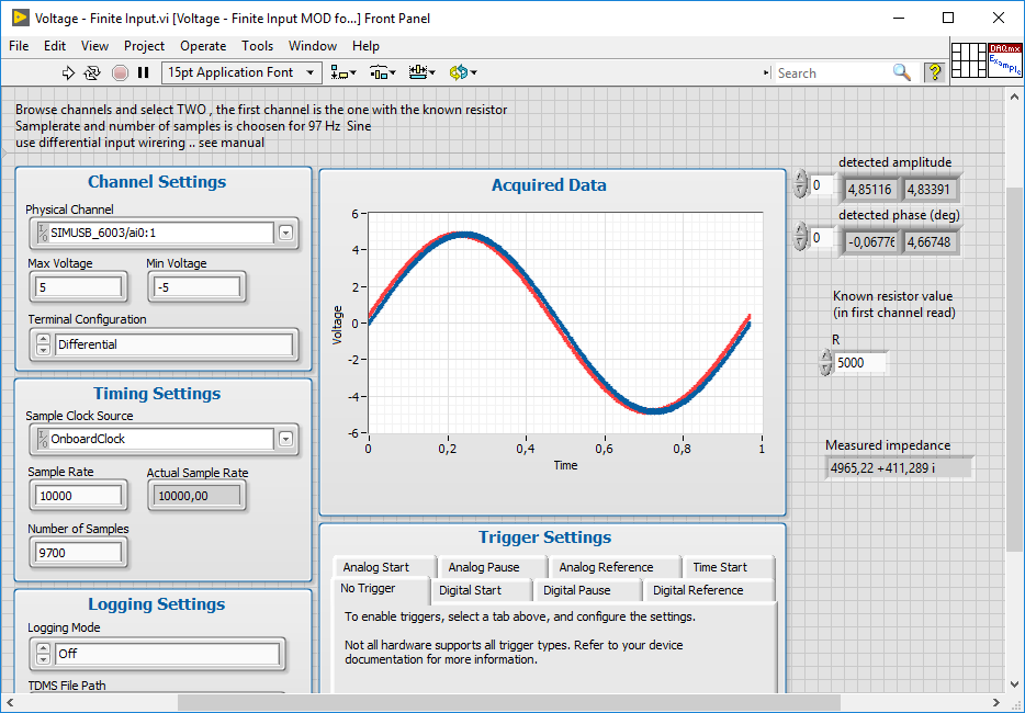

While it running you can use the vi I add, it's a Q&D mod of an example ( press Ctrl to add more channels while browsing in the Physical Channel control)
