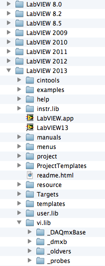

Do you have multiple versions of LV or did you install DAQmx Base before installing LV? It sounds like the installation did not put the VIs in the vi.lib folder.  Check the Applications folder.  Dig down to the folder for the LabVIEW version you are using. In my vi.lib a folder called "_DAQmxBase" is the first folder in vi.lib.

Hi Lynn, thank you for your answer.
I've just found that this version of the DAQmx (3.6.0) is not compatible with LabVIEW 8.6. I should download a previous version.
