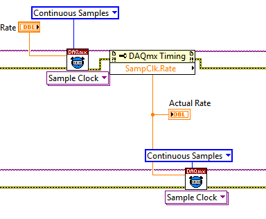

Hi currentenglish,
Some users might want to generate and acquire at different rates but still keep the tasks synchronized (e.g. sample AI on every 4th sample of AO).  If you want the two rates to be the exact same rate you can do something like this:
The reason for wiring back the Actual Rate to the AO task is that AI and AO tasks by default will coerce differently if the desired rate is not an integer divide-down of the timebase.
