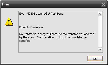

When I attempt to use the unresponsive DAQ with the softpanel in MAX I get the following error.
