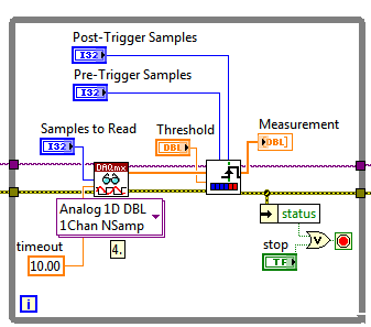

Hi Prevat,
Here's an example to get you started that shows one way to implement a reference trigger in software:
The most basic use case for SW Reference Trigger.vi  looks like this:
            19119iBC7F854CCC80D759
This would implement a reference trigger on a single channel.  If you want to acquire other channels continuously, you would need to split the signal so that you feed only the "finite" channel into SW Reference Trigger.vi.  It is not currently built to allow for triggering from another channel, but this behavior could be added by a slight modification to the VI.
Best Regards,
John Passiak
