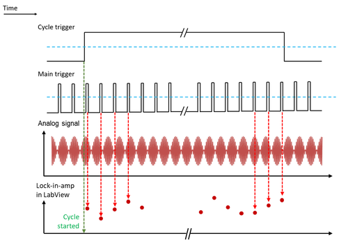

I want to acquire the amplitude and the phase information of my analogue signal with a multiple triggering scheme (I hope the picture would help you understand my issue). I am using the X-series USB6363.
I have two kinds of triggers: a cycle trigger and a main trigger.
Both trigger signals are square waves with different frequencies; 10 Hz for the cycle trigger and 10 kHz for the signal trigger. On the other hand, my analog signal, of which amplitude and phase will be extracted through a software lock-in amplifier, is a sinusoidal wave with a frequency of around 100 kHz (very noisy).
I want to develop a LabView program like this.
(1) The cycle trigger starts a single cycle. The main triggers work for a given times, e.g. 500 times.
(2) When the main trigger is once triggered, the analog signal is recorded for 10 μs at a 2MS/s sampling rate (total 20 points).
(3) The acquired 20 points of 100 kHz analog signal are then analyzed through a software lock-in amp (I already developed a simple one and please suppose there is no time-critical issue). the amplitude and the phase are recorded in two arrays, respectively.
(4) This process is repeated to get every amplitude and phase for every main trigger.
And, I want to repeat the above cycle over 1000 times and then average the amplitude and phase over time to reduce the noise of my analog signal.

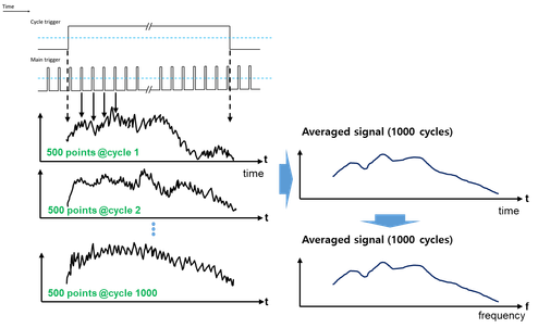

2. The analog signal previously depicted in my post is quite different from the real one, which might baffle the purpose of my cycles. I'm performing optical spectroscopy with a very low optical power from which the spectroscopic signals contain a lot of noise. To overcome this, I want to average the spectroscopic signals in time. Actually, the cycle trigger and the main trigger represent exact optical frequencies that are probed. It means that the n-th triggered signal by the main trigger after the cycle trigger is activated specify an exact optical frequency. After the acquisition, the amplitude and the phase of the analog signal in the time domain will be converted to the frequency domain. I hope the picture below would help understand it.
