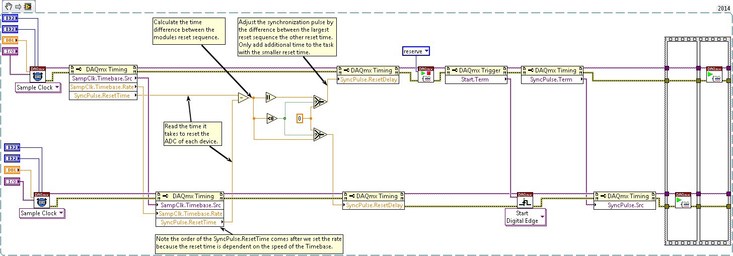

Note being a french national, I also read the tutorial referenced in my own language and notice some differences on the origin of the start trigger for the french translation. Also tried that but doesn't seem to solve the issue I am seeing. also would like to know which one is correct (Compare Figure 8 of the two tutorials :Synchronisation des modules d'entrée analogique de la série C avec NI-DAQmx)
https://ni.scene7.com/is/image/ni/5376%20Fig-08_zhs?scl=1
https://ni.scene7.com/is/image/ni/Figure-8-sync-pulse-reset-time-query?scl=1

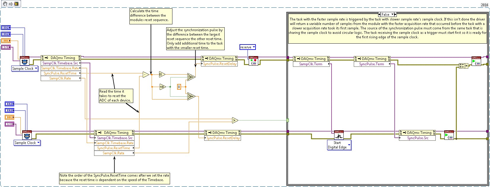

I will second Kevin on the Filter delay being a reasonable justification on the DSA synchronization.
I have dealt with a lot of DSA synchronization on the PXI side and I would assume the same for cDAQ. In order to synchronize both cards, you would need to tell the faster card to delay the capture by the filter delay of the slower card.
This snippet tells you exactly what must be done to slow down the faster card to match up acquisition with the slower card. (i got this from your original link - https://www.ni.com/en-us/support/documentation/supplemental/21/signal-based-synchronization-of-analo...)
