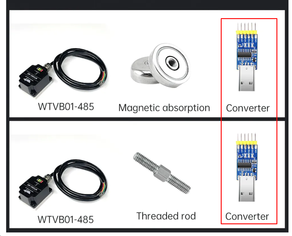

Unfortunately, the USB-600x series low-cost DAQs you've are not useful for the RS485 interfacing.
Next, you can get an off-the-shelf USB-485 adapter like the one shown in the image, do you have such a converter?
Santhosh
Soliton Technologies
Message 4 of 14
(2,589 Views)

Yes, you will get it through the serial port and LabVIEW can read/write data through the serial port.
The straightforward route is through the serial port. Checkout this material - https://labviewwiki.org/wiki/VIWeek_2020/Proper_way_to_communicate_over_serial
Using a NI-DAQ to communicate over RS485 is the most complex and round about way to get it working.
