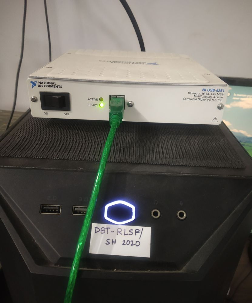

We have a DAQ with product code NIUSB6251.It's not working and the system connected to it showing "no NI device detected ". The ready indicator is on but active one is not showing any light. Please helpIMG_20220130_190618.jpgIMG_20220130_190415 (1).jpg

Thankyou for your suggestion, we are working with the same device and system for last one year. It suddenly stopped working, it blinks the active light just once when the system connected to the device is turned on or when we change the USB port , otherwise the active indicator is off  and only ready indicator is on. It happened once earlier but reinstalling the software (the latest version that is compatible with our device) fixed the problem, but this time that also not working.

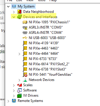

Could you please expand the Devices tree item and share a snippet like the one below?

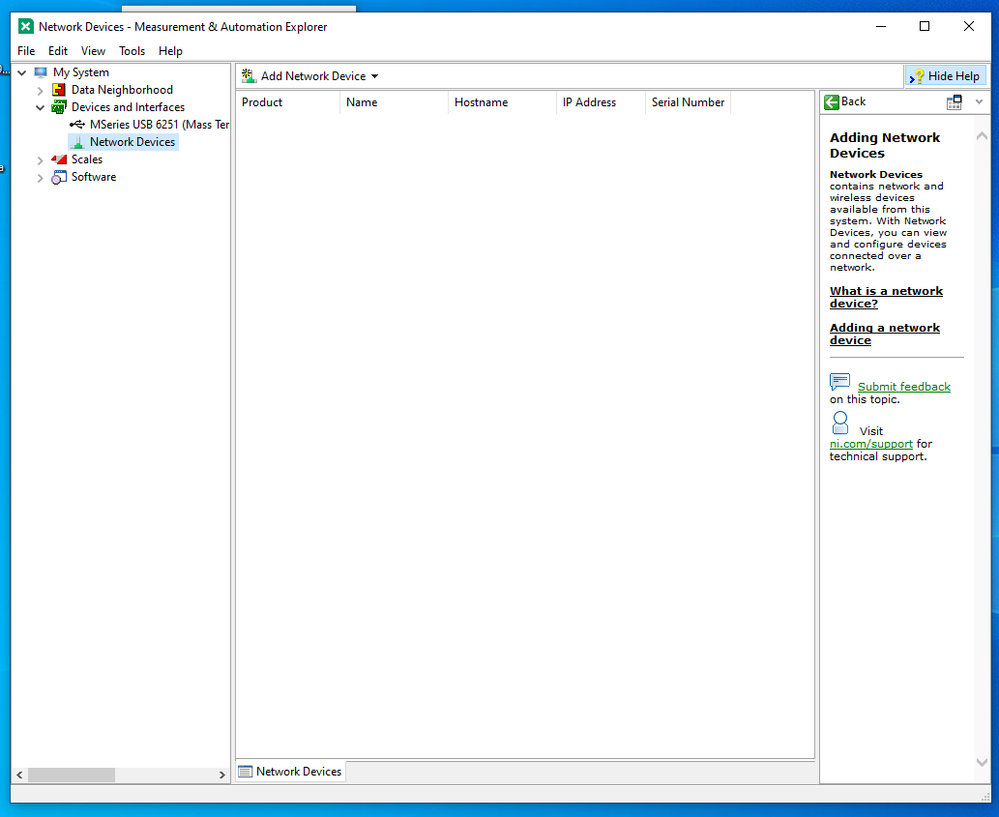

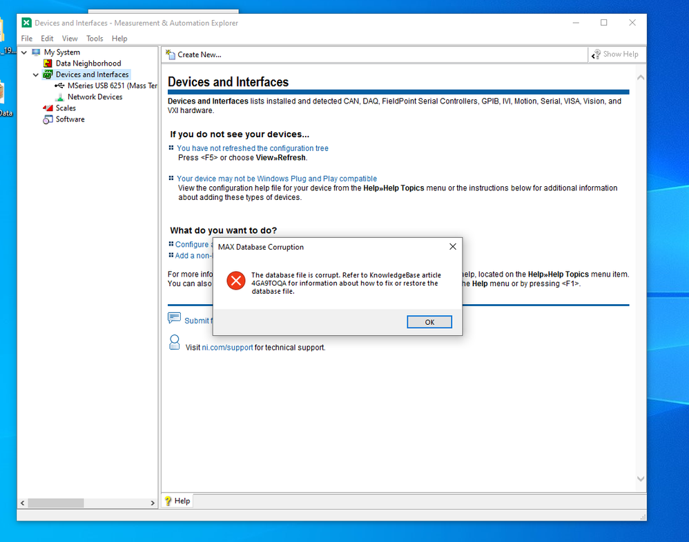

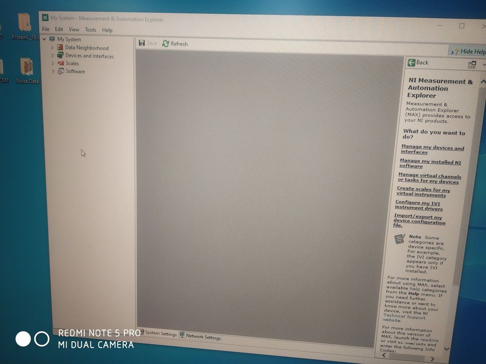

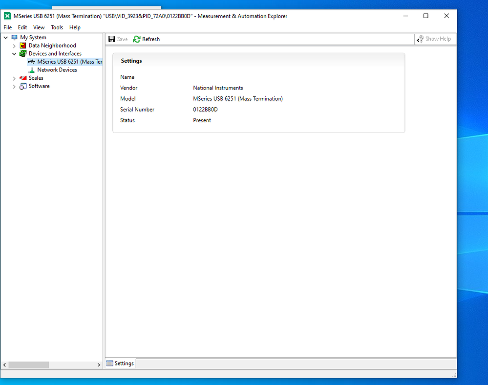

After expending device tree items only have these two options under device and interfaces. Please suggest what we should be doing furtherCapture 3.PNGCapture 2.PNGCapture 1.PNG

You have a corrupted database.  You need to reset it.  In MAX, go to Tools->Reset Configuration Data.
