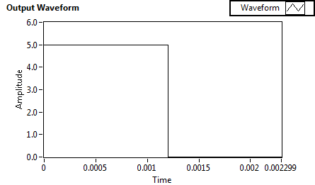

-I was running a vi which generates finite analog voltage with the amplitude of +5V for 1.2 ms (416.67 Hz, 5V, %50 duty cycle, duration: 2.3 ms). I attached the vi for the check.

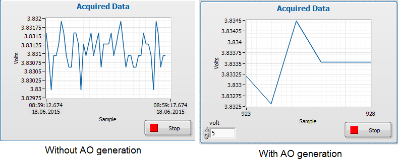

I have just measured the analog output signal after opening the device with the same device analog input channel 0 (I wired AO + to AI 0 + and AO 0 GND to AO -). The left signal is measured from AI 1 without the AO generation, the right one indicates the case AO generation exists (+5V). It seems that AO 0 does not respond the vis. I attached the VIs that I got these images.
P.S. I could not find the multimeter in our lab, that's why I use the device for measurements.

I saw the result from attachments in the previous posts and it clearly shows the extra voltage. To make sure can you please send me a screenshot of the configuation you used for the Continous Input VI. Additionally, can you please try the same physical connections as before, but instead of using LabVIEW use the Test Panel from the NI MAX and send the screenshot as well. This is just as second reference to see if behaviour of this output.
 Jordan

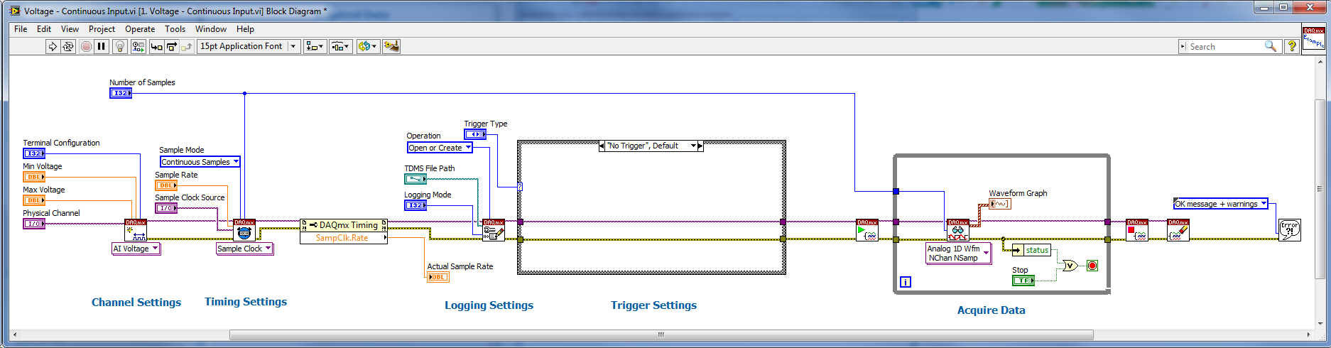

The configuration of the "Continuous Input VI":

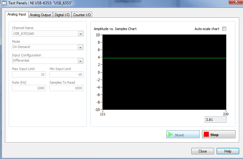

NI-MAX Test Panel screenshot:

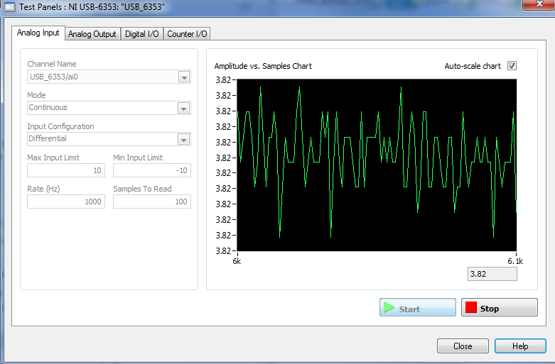

Hi newbieeng,
I was looking at the Test Panel screenchot you sent me and I can't see the extra 5v, the changes in voltages are extremely small and seems as regular noise. I strongly recommend you to use the Test Panel again, ucnheck the auto-scale box and change the scale of the graph to check. If you keep seeing the an odd behaviour the next step would be call NI support to proceed with an RMA.

Hi jred101,
I did as you said, you can see the screenshot below. Unfortunately, there is nothing changes 😕 I think there is a program with AO 0.
