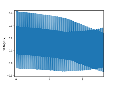

I have a +/-5V (almost) square wave at 50Hz going onto a NI USB 6210 analog differential input, ai0-ai8 (where ai8 is connected to GND). Below is the scope reading taken across ai0-ai8
When I take a differential acquisition on ai0 I get nothing like that,
The frequency is right but nothing else, whats going on here?

If the signal is not differential, you can connect the signal to just ai0 and connect gnd of signal to agnd.
Now ensure that the instrument is functioning properly, connect the signal to ai0-agnd, open DAQmx test panel from NI MAX, configure appropriate settings and observe the waveform.
If the waveform shows up correctly, then the instrument is good, your implementation of code may be incorrect.

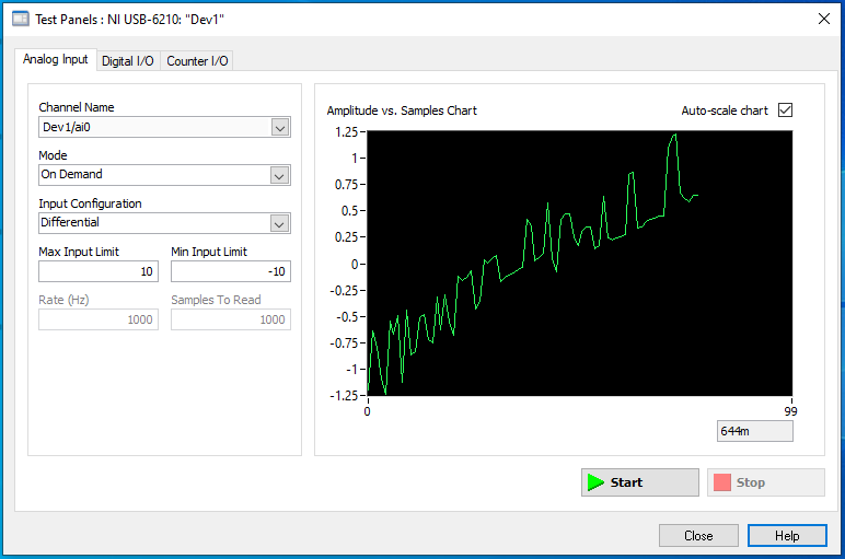

The DAQmx test panel from NI MAX gave an equally odd waveform, even stranger than the one obtained via the Python script,
Can I conclude that this is a hardware fault?
(1,959 Views)
I would not consider this as a hardware fault yet.
Could you please share the connections you have made? what is the signal source? some pictures maybe?

I had the terminal labels, connections & settings wrong, a full-house of wrong!
Label should have been a1, the agnd ref should have been to pin 28 and the terminal configuration should have been NRSE.
Thanks for your help, I should have paid better attention to your initial response & realized I wasn't dealing with a differential input!
