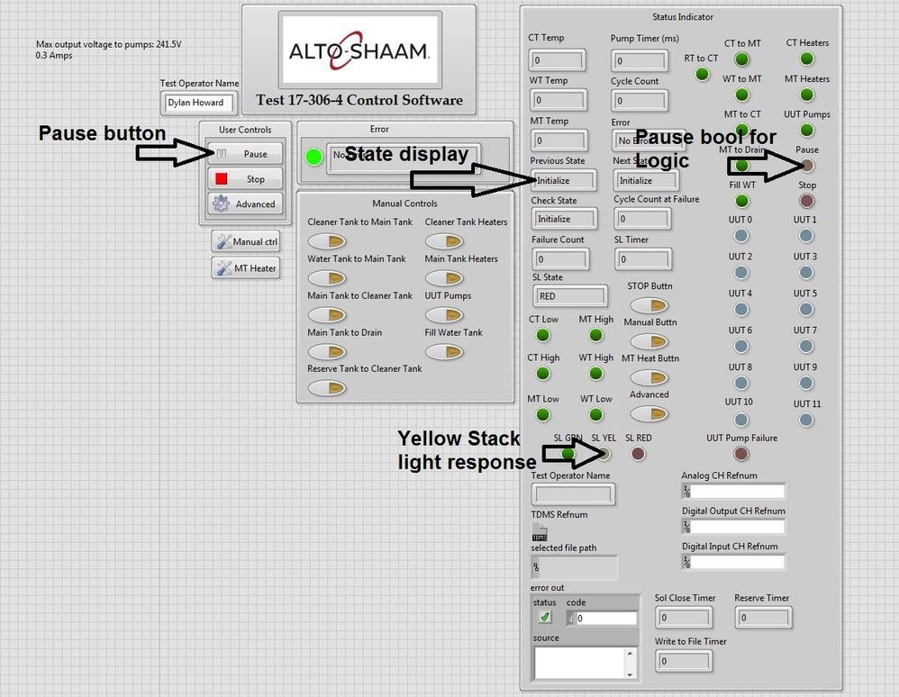

Tim, thanks for your insight. I agree that my code could be better optimized to handle errors, but I positive that none are being triggered. Please see the following:
Looking at your code you only update the display after the heat and fill logic vi. If the code get stuck in one of the other vi's you would never know there was an error.
- You are correct. I update the display every 50 mS, once per iteration of the loop. I know the code is not stuck in another VI because I can continue to interact with it, changing to manual control, hitting pause, etc, and see the state change in my display. However, despite the software sending a command, the DAQ never actually responds. In essence, the VI sends a command, and then waits infinitely for the DAQ to complete the commanded task because it never actually happens. While the VI waits for a response, I can continue to interact with it.
I.E: if I press pause, the display will reflect the state as "pause" and the "pause" Boolean will light up. The output indicator for the stack light will blink, but DAQ never changes the physical light from solid green to blinking yellow. I know this code normally functions properly as I can execute it any number of times before the DAQ locks up.
I can force other errors to be displayed, for instance by canceling the window to create the TDMS address. This automatically prompts a dialog box for the error and ends the program. No such error is detected or reported when the DAQ freezes. The code continues to run normally.
I would also add code to the system that automatically reserves the cDAQ chassis on code restart. I have had this issues myself. I wrote the code to make it recover and reserve the chassis and I never had that problem again.
- This is basically what I am thinking needs to be done. I would like to find a way to detect that the cDAQ is no longer communicating properly and send it a reset command if that occurs. However, I do not know how to implement this. Is there a good example of how that can be accomplished? What can I monitor that will reliably tell me communication status, and how can I programatically send a reset command to the cDAQ?
