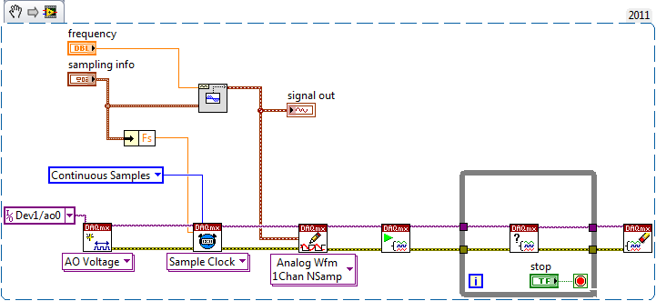

The function generator vi that you are using has an input called sampling info.  You are currently using the default of 1000 samples at 1000 samples per second so it only generates one second worth of data before you repeat it.
(8,712 Views)
You need to configure a sample clock to ensure that your analog output updates predictably.  Additionally, you will want to load your waveform into the buffer and only start the task once.  In your current VI, you are creating your channel each time the while loop iterates, which means that the analog output task will start each time the loop runs.  This means you cannot predict when the analog output will start each time.  You need to do something similar to the following:
In terms of creating the signal you want, I'll expand on what MarkGrot said.  When you create a waveform you specify a sampling frequency and a number of samples.  You also specify the frequency of the signal.  You can mess around with different combinations of sampling frequency, number of samples, and waveform frequency to achieve what you want.  For example, if you wanted to generate a 0.5 Hz signal, you could set the following inputs into the waveform vi:
Frequency: 0.5
Fs: 1000
# of Samples: 2000
This would generate 2 seconds worth of data (2000 S / 1000 S/s = 2 s) which would correspond to one cycle of the sine wave and repeat over and over again.  Because we are actually generating this on hardware, there is a limit to the # of samples we can put in the output buffer.  I'm not sure what chassis or sleeve you are using with the 9263, but just for example if you are using a 9174 you are limited to a buffer size of 8191 samples.
I'd also recommend checking out the example called "Cont Gen Voltage Wfm-Int Clk.vi"  in the NI Example Finder.
I hope this helps clear things up.
Jon S
Applications Engineer
(8,698 Views)
