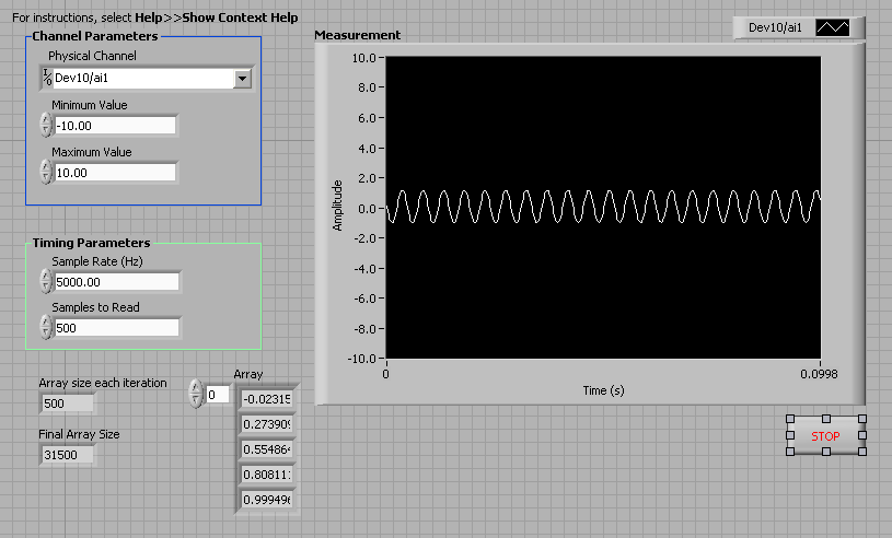

Hi Jeff,
I want you to try your setup with the values I have set below.  I will include the code for this to show that it is the same code as the example, with the slight modification of showing the size of the array coming out of the DAQmx Read and also the building of an array of points so that the output will be a complete array.  As a side note, when testing this out I would suggest removing all modules but the module you are testing just to isolate the one card, then add the modules back in when you have the program working correctly.  The main difference here is that the read samples is 10x less than the sample rate.

Hi Kyle,
Thanks for the example!  My code now works!  It appears I needed to use the functions “Get Waveform Components” and “Insert Into Array” along with a shift register in order to get the data out at the rate I was looking for.
