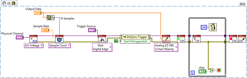

I couldn't open your VI (one of these days I'll install LV 2013...) but to do what you want your code should look something like this:

Hello John_P,
Thank you very much for your reply. I was able to solve the single pulse problem (vi pictured attached as sinepulse vi). I am sucessfully able to acquire a single pulse sine wave using my AO of USB DAQ.
My next problem is to use that Vi as a sub vi and acquire 4 sets of single sine pulse with fixed delay between each signal. and all these should be generated upon a single external digital trigger.  please see pciture Output Vi which gives more detail.
