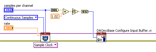

The problem is not in the DMA library, but in the logic of choosing the DMA buffer size. Currently for continuous tasks, DAQmx Base only uses the number of channels in the task and the sample rate to calculate the DMA buffer size. As you've noticed, the driver starts to have problems once reads start approaching one second's worth of data. That directly matches the logic in DAQmx Base: the DMA buffer size is the number of channels multiplied by the sample rate, which give a buffer size exactly equal to a second's worth of data.
The reason that this works for lower channel counts is that once the driver makes the multiplication, it coerces the buffer size to the range [8kB, 2MB]. With your lower sample rates (500S/s), the DMA buffer size doesn't exceed the lower limit until there are 9 channels in the task, so the buffer can hold more than a second's worth of data. If you increased your read size, you would again run into the problem.
In general, whenever you attempt to read the entire circular buffer at once, you enter a race condition. Either the driver will be faster than the DMA transfer and see that not all of the samples have been returned and tell you so, or the driver will be slower and you'll get the DMA overflow error.
The workaround is to call the DAQmx Base Configure Input Buffer VI after the timing VI and manually configure a buffer larger than the number of samples you want to read. An increase as small as 2% worked in my tests, so for a 500S/s continuous task, reading 500 samples at a time, configure a buffer size of at least 510 S/ch.
I've filed a CAR to the group so we can track the problem. The ID number is 182112.
