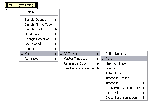

If you're using one of our DAQ devices with DAQmx, the driver configures the device (by default) to the fastest scan rate possible +10 us to allow for settling (at high rates the 10 us is reduced to fit all the channels within a single sample clock period).  To allow more time for settling in between channels, you can increase the time between conversions using the following property node (assuming LabVIEW):
