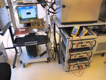

I'm using a 1Ohm, 100W resister and the amplifier is controlled by the analog output of the card.  You can see from the picture below that I have meters on everything.  The card output is correct, the amplifier is responding correctly, and the signal at the input is correct for the programed current.  The problem is when I look at the input in the Test Panel in MAX.
