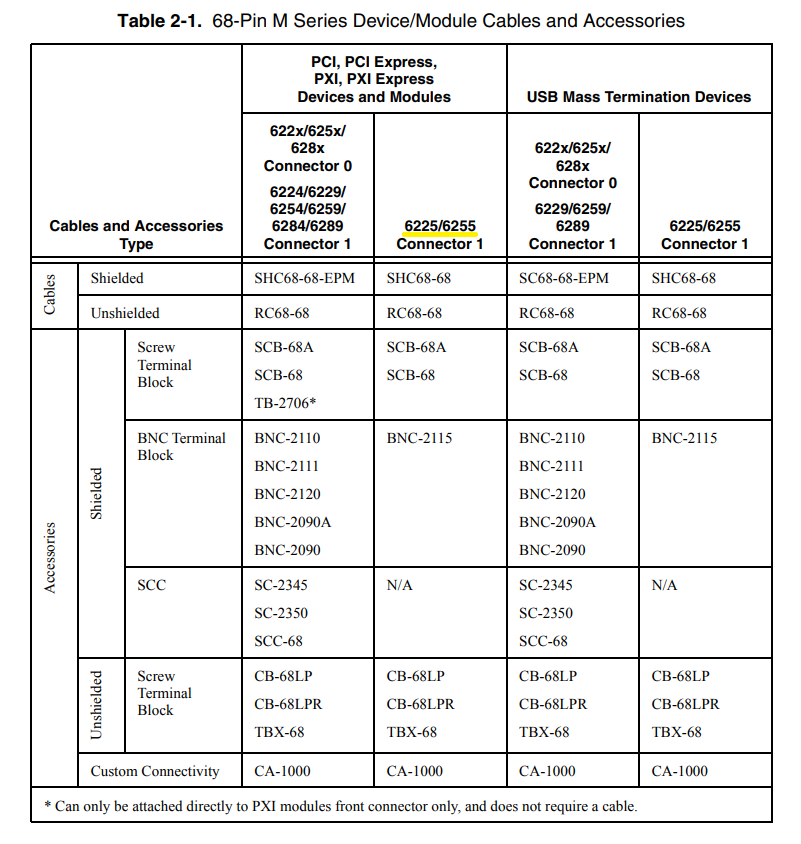

Hi, As per the M-series DAQ users manual, you will need two different cables to work with PCI 6255 module as shown below. Its slightly different for PCI 6254 (it uses SHC68-68-EPM for both connector 0 and 1). I hope this helps.

Thanks very much for this. We will order an SHC68-68 cable fo Connector 1 of the PCI6255.
