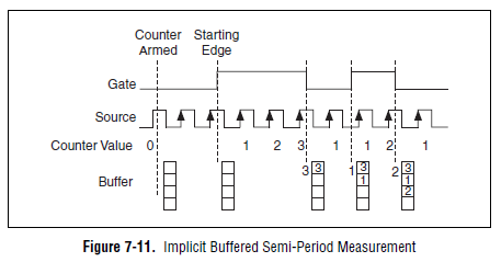

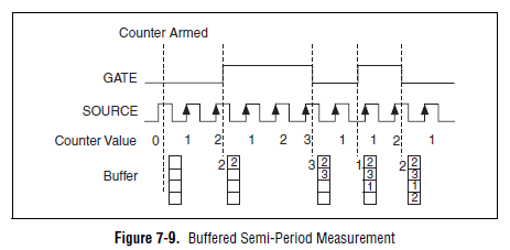

  • The first sample is discarded when performing a buffered period measurement  (image below is for semi-period measurement, but hopefully it shows the idea.  6602 / M Series behavior on the left, X Series behavior on the right):
The X Series throws away the first sample since it is not truly a measurement between two rising edges since the counter is armed asynchronously to the input signal.  If this is an issue, you could instead configure a buffered edge count task to work around the behavior.

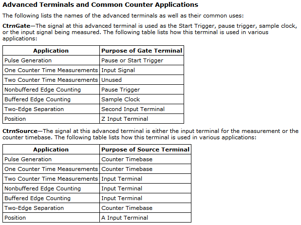

From there, it's a matter of turning your desired functionality into workable software.  The DAQmx Help provides more information about how DAQmx implements various hardware-specific features, but it is not ADE-specific.  For example, one of the first things you might notice is that the hardware refers to "Gate" and "Source" inputs, but DAQmx abstracts this from the user.  The following table from the DAQmx Help (Counter Parts in NI-DAQmx) gives more insight to how to refer to the terminals in DAQmx (a period measurement is an example of a "One Counter Time Measurement").

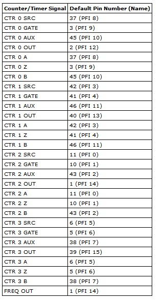

By default, the period task will use the default GATE PFI line as the external signal to be measured in terms of ticks of the internal 100 MHz timebase. The default terminals can be found in the DAQmx Help, but I'll post it here as well for convenience for the 6320:
If you want to change the terminal to be used for your gate, you can do so with DAQmxSetCIPeriodTerm.  If you want to change the terminal used for the source, you can use DAQmxSetCICtrTimebaseSrc.  If you want to continue using the 20 MHz timebase, there is one available on the X Series, but I'd suggest sticking with the 100 MHz default to give more resolution on your timestamps (especially if the input signals are coming in at 3 MHz).
