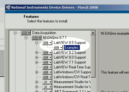

The added complication here is that the 6123 uses DAQmx and the 6561 uses HSDIO. Either way, your examples folder is looking a bit empty, so give this a try:
  • Go to Control Panel » Add/Remove Programs
  • Select National Instruments software and click Change/Remove
  • Find DAQmx and HSDIO in the resulting list.
At this point, you have a couple of options:
  • Click "Modify" and check the installed components. Find your version of LabVIEW and make sure that examples are installed (see below)
  • Click "Repair" to replace the driver files
  • Un-install and re-install both the drivers (making sure that examples are included!)
Hopefully you should be able to see the examples at this point. Failing this, I can post some on the forum for you - it would be better for you to have a full library though!
Good luck!

any idea what location I point to?  I put the 'Device Driver Reference CD' (501648B-01) in a USB CD drive, also tried the LabVIEW 8.5.1 CD (501327E-01), am I using the correct CD, do I need to point to a particular file, or call the CD E: or something ?
Message 8 of 10
(4,180 Views)
another day, inserted the Device Driver CD again, and today it works, examples now populated 🙂
i was using a USB yesterday, so perhaps windows got confused between the CD and USB drives due to all the in-and-out of the usb stick, probably me not ejecting the USB properly.
