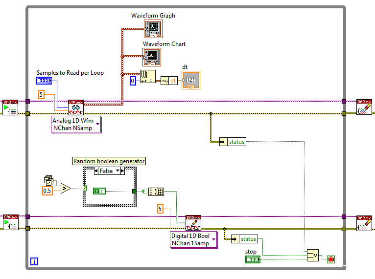

I actually think one of the biggest problems is that you are restarting your Digital task inside the loop every time.  Attached is the revised code for you to try out, the loop now looks like the following:
Notice the DAQmx Start is now called before entering the loop for the Digital Task.  Instead of using a Wait function, you can instead use the Samples to Read parameter so that the ratio of Samples to Read / Sample Rate is equal to the loop time that you desire (DAQmx Read will block until the appropriate number of samples have been received).  I also put the two tasks in parallel so you can now write the digital data while the DAQmx Read is waiting for the desired number of samples.
Simulated devices are often useful but when trying to benchmark performance it is always better to have the actual hardware.  USB in particular has quite a high latency to it; a 1 ms loop time is unfortunately probably not going to be achievable, but the exact performance is going to be system dependant.  Try running this code and see what results you can get--if you are still overwriting samples then you will have to increase the number of samples read per loop (and thus decrease the loop rate).
I hope this helps, be sure to let us know if you have any questions.
