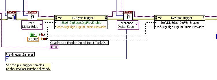

I have a program that uses the DAQmx trigger properties to set the digital filter settings for a DAQmx reference trigger.  This works fine.  I now need to compile because the machine that is connected to the hardware only has a evaluation copy of LabVIEW.  When I bring the code to my laptop the reference trigger options are not showing up and the VI is broken.  I cannot compile.  I am in a real bind because the evaluation period is almost up.

I have DAQmx 9.1.5 and would have the same results as you.  There is not a property for the Digital Filter on the Digital Edge Reference trigger.  That is why it is breaking.  Notice that the property node has black elements rather than the colored data types.  That signifies that it is an invalid property.
