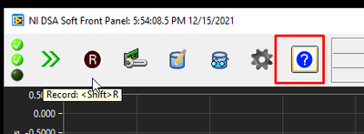

I am not familiar with Python code but trying to relate it with LabVIEW to understand it.
As a quick check to see if the problem is in your code, please try using the DSA soft front panel to quickly start capturing the signal.
https://www.ni.com/en-us/support/downloads/drivers/download.dsa-soft-front-panels.html#376770
You can use the help button in the software to learn how to use this soft panel

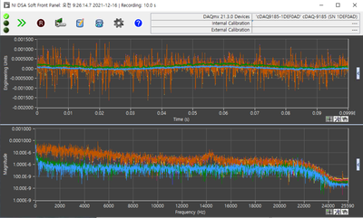

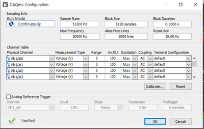

Hi, here is the captured the screens of the option and measuring panel, and please kindly review the recording file attached in this message.
Thank you.

Accepted by topic author Lou_daq
I could not infer anything from the recording.
Question - since these are acceleration sensors if you pick them up and shake, do you see those variations show up on the DSA soft panel - if yes, then the sensor is working
Santhosh
Soliton Technologies
Message 7 of 8
(4,064 Views)
The library doesn't explain the IEPE function enables automatically when you put the internal excitation current with add_accel. I figured out with DSA panel thank you so much. DSA soft panel is really great to trouble shoot for comparing signals with my software, good tip!
