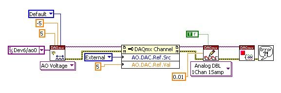

PCI 6713 has a output range -10-10V, but all I need is only 0-5V, so I connect a 5V DC signal to the AO EXT REF on the connector box. The VI I used is the DAQmx Create Channel(AO-Voltage-Basic).vi. Using external reference is done by setting the "output terminal configuration" input of the VI as 10200 following the Help file. The AO voltage value I need is written to the channel by using DAQmx Write (Analog DBL 1Chan 1Samp).vi. The external reference signal does limit the output range but not really results a higher resolution, the minimum step of AO voltage is still the same as before.

Hello Jet,
You need to set the AO ref volatge to external using DAQmx Channel property node.
 Cheers
NI-khil
(3,897 Views)
Thank you very much! Actually, I got it solved exactly the same way as you written!!
