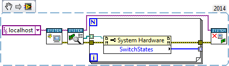

Hello tom1757
i have not the hardware at the moment. You can modify the attached snipped to only
read out your the 9134 hardware switchstates.
I hope this helps
best regards
Alexander
(4,899 Views)
Hello Alexander,
that's the solution, works perfect!
Thank you!
Thomas
