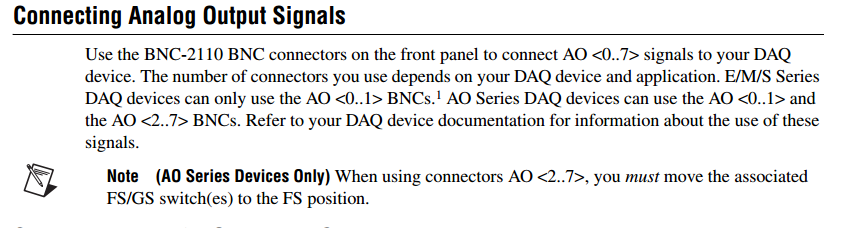

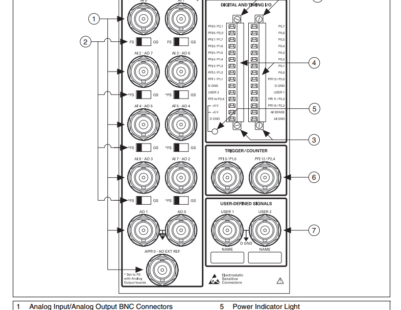

The 2110 has Analog Output BNC connectors that expose up to 8 Analog Output channels onboard your Data Acquisition device. Please take a look at the below picture from the BNC 2110's user manual (page 3) and the following section which discuses the Analog Output BNC pins (page 6).
