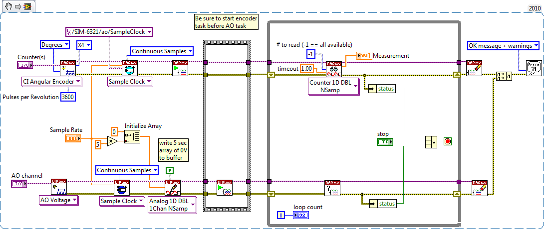

Another thing just occurred to me.  I kinda suspect that you've chosen your sample rate for the wrong reason.  It's a fairly common "mistake" made by people that are. more accustomed to analog acquisition.  It *appears* to me that you're aiming for at least 10x oversampling, a decent rule of thumb for analog work.  That rule is totally unnecessary for counter work.
The counter hardware will accurately track position in its count register regardless of how often (or un-often) you retrieve those counts.  You saw this already when running in a software-timed sampling mode.
With encoder measurement, I would choose a sample rate based on the needs of system dynamics analysis.  That's where the 10x or 20x rule of thumb may come into play.  In the example below, I set the default rate at 2.5 kHz just to show that you don't need 10 kHz.  You might only need about 1 kHz.
I don't have real hw, but this ran just fine with a simulated X-series device. You'll just need to change the device/channel designations.
-Kevin P

Hey Thanks Kevin!
I think part of my problem was not starting the encoder task before the AO task which produced an error. Now that I have that issue cleared up, back to my base question. If the encoder count regester tracks position accurately at each pulse when it receives a pulse (or count) how can I save that data over time in say TDMS/Excel/Text? Going back to your point about the sample rate, I completely agree. It makes sense to me that the sample rate does not matter for counter work until I want to know what that is over time (dynamically) and record that information. It is my understanding that once I can save data in TDMS, I can export it or convert it into a different form. Not that I want to add complexity to the mix, but I'd like to be able to trigger the recording of that encoder data at a specific position and end it after a certain position (in degrees). If you could point me in the right direction for that, I would be grateful.
Thanks for the help!
FYI - This code worked with my hardware without any issues. Thanks!
