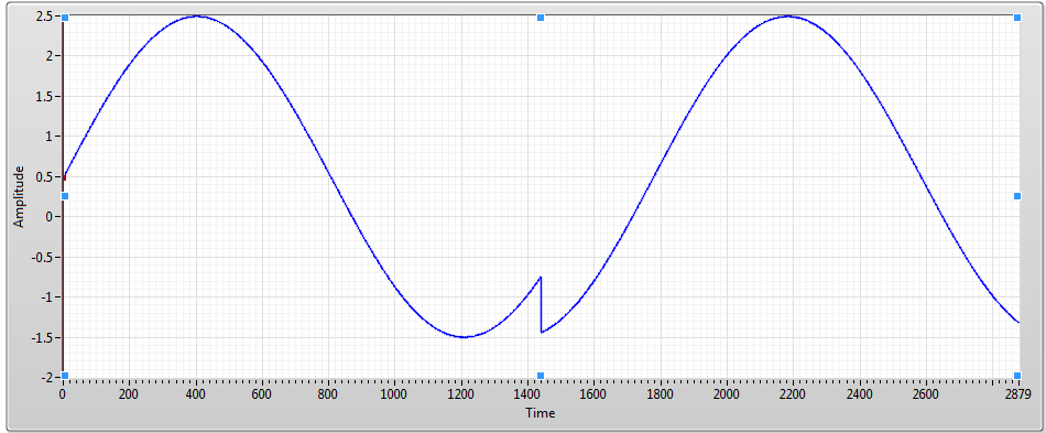

Unfortunately, I'm seeing some issues here.  I'm seeing discontinuity in the acquired waveform at the trigger point.  The last point before the z-pulse is significantly different (both value an slope) from the next point acquired.  The only thing that I can think of that is happening is that it's missing that trigger and waiting for the next one giving every other set of data.  Unfortunately, I've not been able to determine if this is the case because I don't have something set up to give me different waveforms on consecutive rotations (meaning every other rotation would have the same signal and if it's skipping a rotation, I would get the same data on every dataset).
Also, this is only happening at higher RPMs.  It seems to look fine at ~400 rpm but when I try ~1000rpm it shows these discontinuities.  I've attached an image of my results.
Any help would be much appreciated.

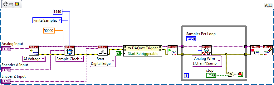

Are you using the retriggerable property?
Trying to restart the task in software would give you the behavior you described.  If this isn't the issue, you should post your code.

Thanks for the reply.  I am using the retrigger property but I think I found the problem.  I narrowed it down to a subVI that I created that did a little processing on the data before displaying (some data shifting) and I was using the VI in two places and it uses an uninitialized shift register.  So, by default it was non-reentrant meaning it was accessing the same memory causing a something like a race condition but much worse.
I was able to make them run independently which fixed the problem.
