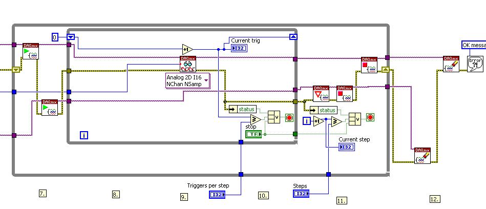

I tried running your code on a PCI 6251 with no errors.  The case structure in the while loops may be causing some unnecessary delay on your machine.  Try removing the case structure and get rid of the DAQmx Is Task Done vi.  Specify the number of samples per channel on your DAQmx Read vi.  Also, make sure your trigger is TTL compliant.  Keep me posted on your results.

I suspect the triggers are missed because your application is unable to update fast enough.  You can delete the case structure as long as you are sure to reconnect the necessary wires. What are the specifications of your machine?  What happens when you slow down the sample rate or reduce the number of steps (do you avoid the error completely)?

Hi Hani, thank you for your continued help.  My computer is running Windows XP.  It's a Dell Dimension 4550 Pentium 4, 2.4 GHz processor w/ 1 GB of RAM.  I'm still not sure what you mean by delete the case structure; if I do this how do I check to see if I should perform a read?

You can remove the case structure by right clicking the Case Structure and selecting Remove Case Structure.  Delete the Property Node as well (shown in the screen shot of the VI I edited).  Wire the Samples per Channel input to the Number of Samples per Channel of the DAQmx Read VI.
I also added a DAQmx Wait Until Done VI before the DAQmx Stop (also shown in the screenshot), which will ensure that the pulse generation is complete before executing the DAQmx Stop Task.
Let me know if adding the DAQmx Wait Until Done VI changes anything.
