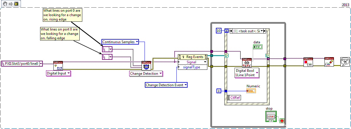

The VI you posted is not  yielding change detection events because you have not enabled this feature in hardware. To enable this feature you have to utilize the Change Detection Instance of the DAQmx Timing.vi. Please take a look at the snippet below where I modified you code to  enable this event.

When you receive the TTL signal from the motion controller are you interested in logging the data acquired at the moment (Before and after the trigger), or do you want to store the data from the beginning of the acquisition until the trigger was received? What do you mean by "begins next continuous acquisition"?
If you are only interested in the data surrounding the trigger then a reference trigger would be useful for your application. This will give you the option of acquiring samples before and after the TTL signal. Although you can only set up to acquire a finite amount of samples and will have to stop and restart the task if you hope to continuously acquire. While stopping and starting the task there is a chance of missing the next TTL pulse if the TTL pulse arrives during the time you are restarting the task. This can be mitigated by reducing the time between the Stop and Start with the DAQmx Control Task.vi in order to commit the task. If you are interested in the latter then a continuous acquisition with a modified version of the change detection code to log the data when the external event is received would be the route I would take.
Also, since the title of this post is retriggerable waveforms with external stop trigger, please take a look at this example for how to implement a Stop Trigger. In order to make this retriggerable you will have to stop and start the task (after the trigger has been received) which like I mentioned above may cause you to miss the next trigger if the trigger arrives during the restart.
